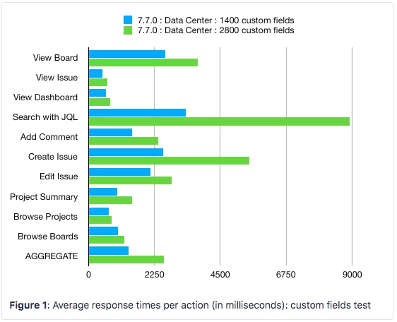

In our scaling tests, we've found that a large number of custom fields is the number one reason for performance degradation. Limiting the number of custom fields and workflows, as well as reusing schemes where possible, not only helps your Jira instance maintain satisfactory performance levels, but also makes administration less complicated.
Custom fields can be configured in a variety of ways, including setting the applicable context, field configurations, and screen schemes and including the three of them in various combinations. In the test below, all the custom fields are set to global in order to see how much of an impact the raw number of custom fields has on performance.
The figure shows that:
- The number of custom fields has a high impact on actions that request or process custom issue details — viewing, searching, creating, editing, and commenting on issues.
- It has a lesser, but still slightly noticeable impact on actions such as viewing dashboards and browsing projects.
