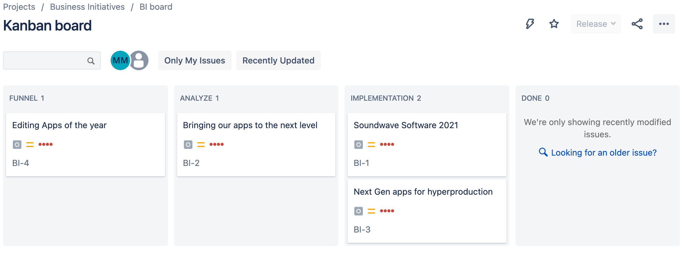

A kanban board can provide a transparent place to manage and view organizational initiatives. You can also use a kanban board to create an acceptance process.
But how does an initiative make it to a roadmap? New initiatives can be moved along the acceptance process based on required criteria like fields. Once the initiative reaches the implementation status, it can be automatically pulled into a roadmap. This also allows for prioritization throughout the acceptance phase.

You will need to decide if initiatives should be created in their own project or in individual projects. You will also need to consider the workflow statuses and fields that will apply to the initiative issue type.
Think about what level of data and reporting your organization will need.
Example: How many initiatives are in the analyze phase? How many initiatives are in implementation for a specific line of business?
A kanban board can be based on a single project or you can create a filter to select initiatives and create a kanban board based on that filter.
